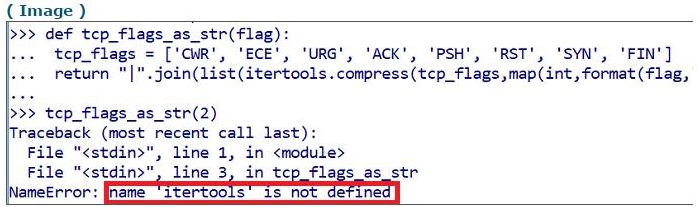

Which of the following commands would correct the error in the screenshot?
The error in the screenshot indicates that the name 'itertools' is not defined. This means that the itertools module has not been imported into the current namespace. To fix this, you need to import the itertools module at the beginning of your script using the command 'import itertools'. Therefore, option A is the correct choice.
VenudharOption: A
Nov 18, 2023
The option is A
