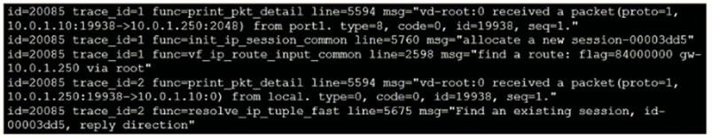

Refer to the exhibit showing a debug flow output.
Exam NSE4_FGT-6.4 Question 69
Which two statements about the debug flow output are correct? (Choose two.)
Correct Answer: AD
The debug flow output displays that the protocol used is ICMP, indicated by 'proto=1', which is correct for identifying ICMP traffic. This justifies option A. Additionally, the message 'allocate a new session-00003dd5' confirms that a new traffic session is created, justifying option D. There is no indication in the provided debug that a firewall policy is directly allowing the connection or that the default route is needed to receive a reply, making options C and B incorrect.

A & D is correct, not C

AD is correct. Good read for your guys. https://docs.fortinet.com/document/fortigate/6.2.3/cookbook/54688/debugging-the-packet-flow

A & C is correct : proto=1 -> icmp / allocate a new sesion

A & D is correct. No Doubt.

A and C ,, reply traffic is received so traffic must has been allowed by a firewall policy

looking again a the log, it seems that the client is pinging the GW in the same subnet, son firewall policy is needed to allow such communication. Answer should be A,D as mentioned by others

Why do you think it`s a gateway? How can you know it?
Anis_chak
Oct 24, 2021
"gw-10.0.1.250 via root"

A&D A=proto1=ICMP=PING D=msg="Allocate a new session"

If C is not correct, why is there a return traffic in reverse direction from 10.0.1.250 back to 10.0.1.10?

Proto 1 is icmp. Obviously a new session was created. The ping is being sent to the gateway from a local device so no policy is needed. "gw-10.0.1.250 via root" Fortigate Infrastructure 7.0 pg 358-360
