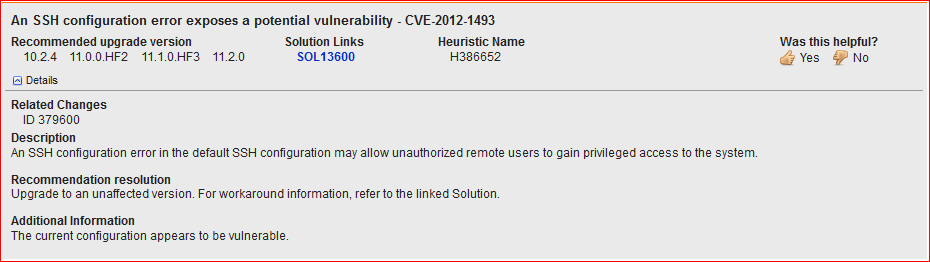

An LTM Specialist is working on an LTM 11.0.0 installation and has identified a security vulnerability as shown in the exhibit. The LTM Specialist is tasked with applying the latest available hotfix to resolve the problem.
Which procedure resolves the problem?
The latest recommended hotfix for resolving the identified security vulnerability on an LTM 11.0.0 installation is 11.1.0.HF3. To resolve the problem, you should navigate to System > Software Management > Hotfix List, import the 11.1.0.HF3 hotfix to the available hotfix images, select the imported hotfix image and installation location, and then click Install. This ensures you are applying the correct fix as per the specific recommendation for your current version.
GVKDOption: B
Feb 13, 2024
B - Correct How to install hotfix files Navigate to Main-> System->Software Management -> hotfix List https://sanchitgurukul.in/2019/03/22/f5-ltm-how-to-apply-hotfix/
