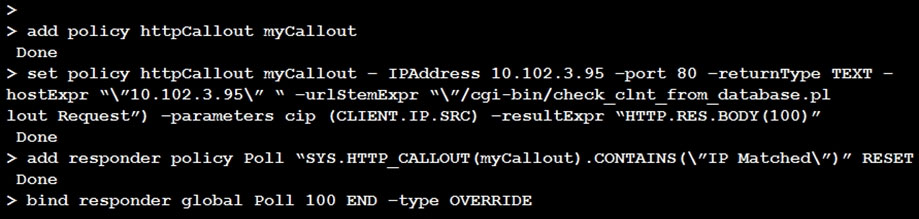

Scenario: A Citrix Administrator configured the HTTP_Callout feature on the Citrix ADC using the command-line interface. After configuring the commands, the device is facing the HTTP callout recursion issue.
Click on the 'Exhibit' button to view the screenshot of the command-line interface.
How will the administrator rectify the issue?
To fix the HTTP callout recursion issue, the Citrix ADC Responder policy needs to ensure that it does not continually trigger the HTTP callout. This can be achieved by changing the expression of the Responder policy to include a condition that prevents recursion. Since the current issue involves recursion, adding a condition to exclude requests that are marked by the HTTP callout should resolve it. The expression 'HTTP.REQ.HEADER("Request").EQ("Callout Request").NOT && SYS.HTTP_CALLOUT(myCallout).CONTAINS("IP Matched")' ensures that the callout is only made if the request header does not already indicate it is a callout request and if the callout result contains
