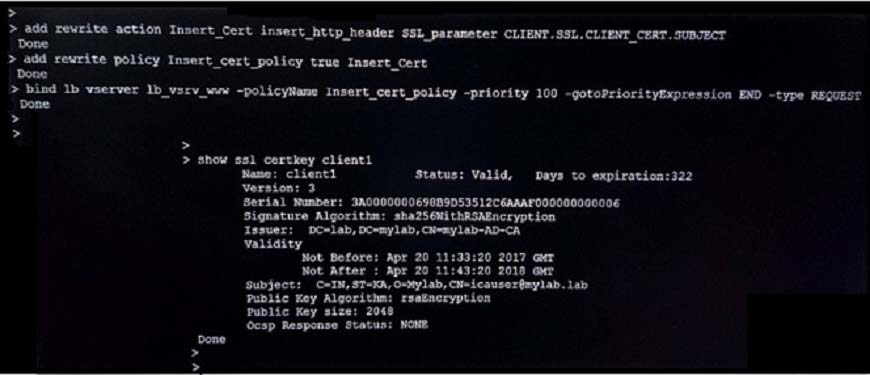

View the Exhibit.
A Citrix Administrator has configured the commands using the command-line interface.
Click on the Exhibit button to view the screenshots of the command-line interface.
What will be the effect of the rewrite policy, based on the exhibit?
The rewrite policy is designed to insert an HTTP header with the SSL parameter, which contains the subject of the client certificate, on every request. The command explicitly indicates that this rewrite policy applies to requests due to the term 'type REQUEST' found at the end of the bind statement. Therefore, the correct answer is that the HTTP Header SSL_parameter: C=IN, ST=KA, O=Mylab, CN=[email_protection] will be inserted in every REQUEST.
GTJOption: D

Should be D. In the exhibit command clearly states -REQUEST at the end, meaning rewrite is triggered on every request. Also please note SUBJECT line in the exhibit, it is not only users's FQDN
