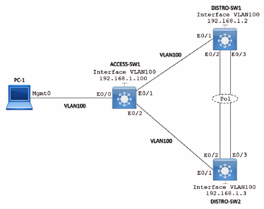

Implement GLBP between DISTRO-SW1 and DISTRO-SW2 on VLAN100 for hosts connected to ACCESS-SW1 to achieve these goals:
1. Configure group 30 using the virtual IP address of 192.168.1.254.
2. Configure DISTRO-SW1 as the AVG using a priority value of 130.
3. If DISTRO-SW1 suffers a failure and recovers, ensure that it automatically resumes the AVG role after waiting for a minimum of 35 seconds.

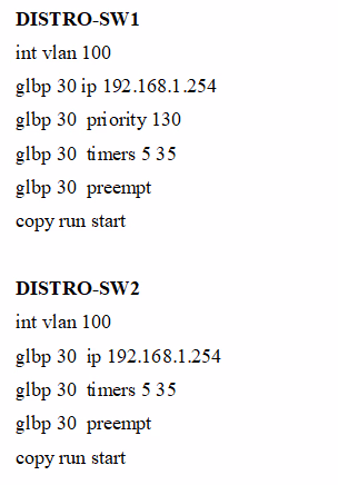

Primary Switch: interface Vlan100 ip address 192.168.1.2 255.255.255.0 glbp 30 ip 192.168.1.254 glbp 30 priority 130 glbp 30 preempt delay minimum 35 end Secondary Switch: interface Vlan100 ip address 192.168.1.3 255.255.255.0 glbp 30 ip 192.168.1.254 https://www.cisco.com/c/en/us/td/docs/ios-xml/ios/ipapp_fhrp/configuration/15-mt/fhp-15-mt-book/Configuring-GLBP.html

Tbh I wouldn't touch the counters. I think they want us to configure preempt delay instead: Primary SW: glbp 30 ip 192.168.1.254 glbp 30 priority 130 glbp 30 preempt delay minimum 35 Secondary SW: glbp 30 ip 192.168.1.254

i actually would put the preempt command with the delay on the second too, just in case the second boots up first and takes the active role

The way I understand it is, SW1 has a higher priority + preempt so as soon as it is up, it will count 35 seconds then take over the Active role from SW2.

This exercise requires to change the hold time value. The hello time is not mentioned. I suppose that it is better to leave the hello time on the default 3 sec, and only change the hold time to 35 sec (from 10 sec). interface Vlan100 ip address 192.168.1.2 255.255.255.0 glbp 30 ip 192.168.1.254 glbp 30 timers 3 35 glbp 30 priority 130 glbp 30 preempt #show glbp Vlan100 - Group 30 State is Init (interface down) Virtual IP address is 192.168.1.254 Hello time 3 sec, hold time 35 sec Redirect time 600 sec, forwarder timeout 14400 sec Preemption enabled, min delay 0 sec Active is unknown Standby is unknown Priority 130 (configured)
fasttony77
Apr 12, 2023
It is the preempt delay timer that it is asking for, not the hold time. glbp 30 preempt delay minimum 35

i understand the hold time is the fisrt thing in mind but i would like to refer that when the hold time is overcome, the protocol recalculates who will be the AVG. In delay is more bounded

It was requested to configure the hold time 35 sec on SW1. SW2 is not mentioned. Thus, I only configured it on SW1. Actually, SW2 (standby AVG) took the timer values from SW1 (active AVG) anyways.

I agree, hold timer manipulation is not the means of delaying preempt. The hold time is when an AVG will determine a failure has occurred. If the question was asked to delay action on failure, then managing the timers would be appropriate, though in real world probably not ideal. But criteria is about the primary delaying taking back AVG role.

"Use the optional delay and minimum keywords and the seconds argument to specify a minimum delay interval in seconds before preemption of the AVG takes place. " https://www.cisco.com/c/en/us/td/docs/ios-xml/ios/ipapp_fhrp/configuration/15-mt/fhp-15-mt-book/Configuring-GLBP.html
