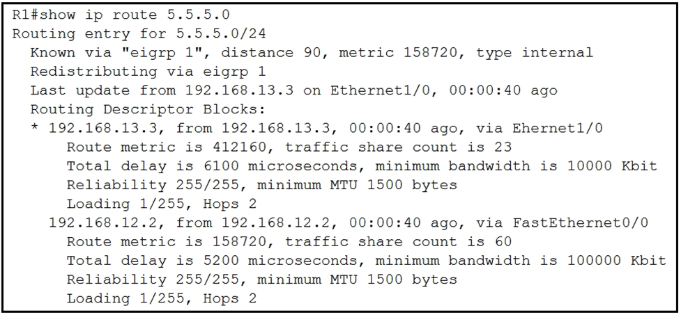

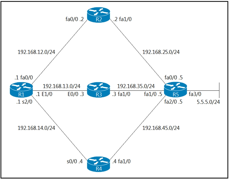

Refer to the exhibits. An engineer investigates a routing issue on R1 and finds that traffic destined to 5.5.5.0/24 does not take all of the paths.
Which action resolves the issue?
The reason traffic destined to 5.5.5.0/24 does not take all of the paths in EIGRP is likely due to the current EIGRP variance setting. EIGRP's variance command allows for unequal cost load balancing by including routes that have a feasible distance up to the specified times the best route's metric. Increasing the variance value will include additional paths that are not currently being utilized because their metrics are higher than the existing variance setting allows. Thus, increasing the variance value will likely resolve the issue by enabling EIGRP to load balance across multiple paths of different metrics.

Correcto A EIGRP variante enables unequal cost path balance routing and add those prefixes to the EIGRP routing table. Regards
HungarianDishOption: A
May 30, 2023
FD of feasible successor / FD of successor ≈ variance 412160 / 158720 = 2.59 -> variance = 3
