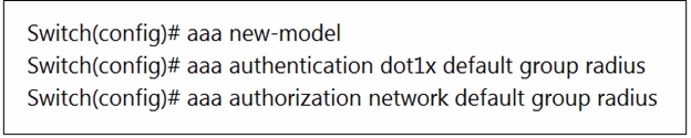

A network engineer is configuring the switch to accept downloadable ACLs from a Cisco ISE server.
Which two commands should be run to complete the configuration? (Choose two.)
Correct Answer: BC
To configure a switch to accept downloadable ACLs from a Cisco ISE server, two essential commands must be run. The 'ip device tracking' command is required to enable the switch to track IP device information, which is necessary for ISE to provide dynamic access policies based on the device's IP address. The 'dot1x system-auth-control' command is necessary to enable 802.1X authentication on the switch, which allows the switch to forward authentication requests to the ISE server. Without enabling 802.1X globally, the switch would not be able to use the dot1x feature needed for downloadable ACLs.
