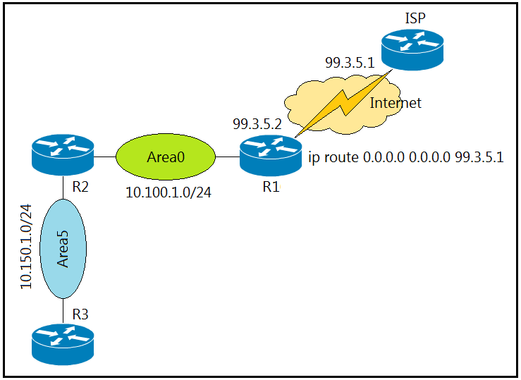

Refer to the exhibit. A network administrator redistributed the default static route into OSPF toward all internal routers to reach to Internet.
Which set of commands restores reachability to the Internet by internal routers?
The correct command to restore reachability to the Internet by internal routers in OSPF is 'router ospf 1 default-information originate'. This command tells the router to generate and advertise a default route (0.0.0.0/0) into the OSPF domain, allowing internal routers to forward traffic destined for unknown networks to the router originating the default route, which in this case has a static route to the internet.

Why do we need to do in ospf default-information originate always ? As you probably already know, default-information originate tells the router to inject any default route that has been configured on the router into the OSPF. The OSPF router does not, by default, generate a default route into the OSPF domain. In OSPF, the “default-information originate” command will not advertise to any other routers without a default route in the routing table. When added the “always” keyword , it tells the router to advertise a default route to other routers even if you don't have a default route in the routing table

Any OSPF router can originate default routes injected into a normal area. The OSPF router does not create a default route into the OSPF domain by default. The ‘default-information originate’ command is required for OSPF to generate a default route.

The correct answer is: D. router ospf 1 default-information originate
