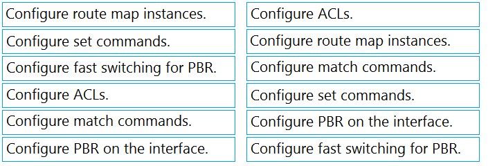

300-410 Exam - Question 55
Drag and drop the actions from the left into the correct order on the right to configure a policy to avoid following packet forwarding based on the normal routing path.

Give answer is correct. Here is a better source: https://howdoesinternetwork.com/2013/configuration-of-pbr-policy-based-routing
Gramterre
Mar 28, 2024
According to your source the answer is wrong as fast switching should be done last : "Fast switching PBR will be applied only to PRB policies that are set prior to enabling it. It you define some other PBR policies later you will need to enable fast switching PBR again."
Gramterre
Mar 28, 2024
My bad you're worng I looked the answer too fast
Gramterre
Mar 28, 2024
you're right*
examShark
Aug 4, 2021
The given answer is correct
Vainius
Oct 4, 2021
https://community.cisco.com/kxiwq67737/attachments/kxiwq67737/6016-discussions-lan-switching-routing/26658/1/8609-PBR%20configuration.pdf
conft
Aug 24, 2023
the given answer is correct.
SeMo0o0o0
Jul 17, 2024
correct
