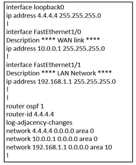

Which set of commands restore reachability to loopback0?
In OSPF, loopback interfaces are treated as host routes by default, meaning they are advertised with a /32 mask. This can cause issues if the network requires the loopback interface to be advertised with its configured subnet mask, such as /24 in this case. To restore reachability with the correct subnet mask, the command 'ip ospf network point-to-point' should be applied under the loopback interface. This command forces OSPF to advertise the loopback interface with the configured mask instead of the default /32 host route. Thus, the correct set of commands to restore reachability to loopback0 is option A.

I understand the answ, but please, somebody explain, to me how the original config can make 4.4.4.4 unreachable. Thanks !
OhBee
Jan 21, 2022
I believe it is because the route is advertised as a /32 (since OSPF does that by default for loopback interfaces). In order for it to be advertised properly as a /24, the configuration shown in A should be done.
bogd
Feb 21, 2022
Having the route advertised as a /24 or /32 really doesn't matter - 4.4.4.4 would be reachable in both cases. The phrasing of the question is absolutely terrible...
piojo
Jun 2, 2022
Point is that if you configured the loopback as a /24 is because you need the whole /24 to be advertised as well (for other purposes like NATed addresses). Otherwise you would configure the loopback as /32.
Carl1999Option: A
Feb 3, 2022
Loopbacks are considered host routes in Open Shortest Path First (OSPF). To make OSPF advertise the loopback subnet as the actual subnet with the loopback mask, instead of as host route /32, issue the ip ospf network point-to-point command under the loopback interface. For more information, refer to the 9.1. Interface States section of RFC 2328.
diogodds
Mar 12, 2022
The question is really horrible as mentioned by @bogd, with the current interface and ospf configuration, the loopback would also be reachable.
Pietjeplukgeluk
Nov 19, 2023
Fully correct, the loopback would be reachable however it would advertise /32 instead of a /24. So there is no need to correct any configuration, changing it would only advertise different mask, but you would not be able to reach any other interface in the actual advertised network. Stupid question.
heeeeyajokeOption: A
Dec 19, 2022
I have tested the lab, i could still reach the loopback, OSPF advertised a /32 route for the loopback by default. But i would go for the option A for the exam
anaisa_goncalvesOption: A
Nov 10, 2022
Here's the explanation: https://networkengineering.stackexchange.com/questions/13099/why-do-we-use-ospf-point-to-point-networks-for-loopbacks
XBfoundXOption: A
Jun 9, 2024
The network type broadcast is not accepted in the loopback interfaces. R4(config-if)#ip ospf network broadcast % OSPF: Invalid type for interface Loopback0 So for allow to exchange the loopback as not as a /32 network the only option that we have is use the command ip ospf network point-to-point command under the loopback interface
