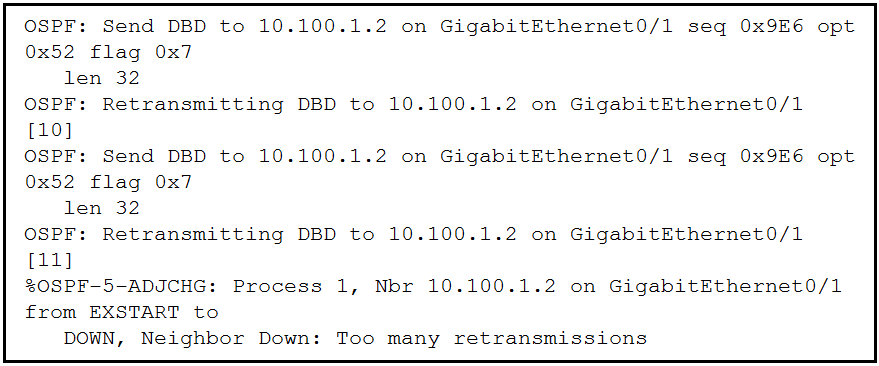

Refer to the exhibit. The OSPF neighbor relationship is not coming up.
What must be configured to restore OSPF neighbor adjacency?
In Open Shortest Path First (OSPF), matching MTU values across interfaces is crucial for establishing and maintaining neighbor adjacencies. If the MTU values do not match, the routers may not be able to properly exchange database description packets, leading to the failure of forming a neighbor relationship. The retransmissions and eventual failure to establish OSPF adjacency shown in the exhibit are indicative of an MTU mismatch. Therefore, to restore OSPF neighbor adjacency, the MTU values must be matched.

*Jan 10 07:12:55.724: OSPF-1 ADJ Et0/0: Rcv DBD from 10.10.10.2 seq 0x1BFC opt 0x52 flag 0x7 len 32 mtu 100 state EXCHANGE *Jan 10 07:12:55.724: OSPF-1 ADJ Et0/0: Nbr 10.10.10.2 has smaller interface MTU *Jan 10 07:12:55.724: OSPF-1 ADJ Et0/0: Send DBD to 10.10.10.2 seq 0x1BFC opt 0x52 flag 0x0 len 32 IOU1#undebug all All possible debugging has been turned off IOU1# IOU1# IOU1# *Jan 10 07:13:06.410: %OSPF-5-ADJCHG: Process 1, Nbr 10.10.10.2 on Ethernet0/0 from EXCHANGE to DOWN, Neighbor Down: Too many retransmissions IOU1# *Jan 10 07:14:06.417: %OSPF-5-ADJCHG: Process 1, Nbr 10.10.10.2 on Ethernet0/0 from DOWN to DOWN, Neighbor Down: Ignore timer expired

D is correct https://www.cisco.com/c/en/us/support/docs/ip/open-shortest-path-first-ospf/119384-technote-ospf-00.html

D is correct : https://www.cisco.com/c/en/us/support/docs/ip/open-shortest-path-first-ospf/13684-12.html
