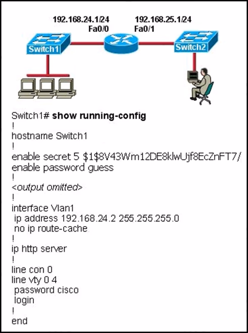

The network administrator cannot connect to Switch 1 over a Telnet session, although the hosts attached to Switch1 can ping the interface Fa0/0 of the router.
Given the information in the graphic and assuming that the router and Switch2 are configured properly, which of the following commands should be issued on
Switch1 to correct this problem?
The command 'Switch1(config)# ip default-gateway 192.168.24.1' is necessary to set the default gateway for Switch1. This allows the switch to forward packets that are not destined for its local subnet, facilitating communication with devices on other subnets. Since the hosts attached to Switch1 can ping the router's interface, it implies that routing is fine, but the switch itself needs a proper default gateway to handle Telnet sessions from different subnets.
