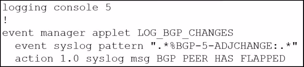

Refer to the exhibit. The EEM applet must generate a syslog message when a BGP adjacency flaps. This message must be displayed to the console of the switch. However, when a BGP adjacency failure is simulated, no syslog message is displayed. Which action resolves the issue?
The EEM applet is designed to generate a syslog message when a BGP adjacency flaps and display it on the console. The current configuration appears correct, but it is not working as expected because the logging priority might not be high enough to be displayed on the console. Setting the logging priority to Warnings ensures that the syslog messages generated by the EEM applet are displayed on the console, resolving the issue.

the question doesn't seem to be correct
scorpfeOption: D
Apr 8, 2025
I think D
