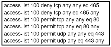

Refer to the exhibit. During troubleshooting it was discovered that the device is not reachable using a secure web browser.
What is needed to fix the problem?
The access control list (ACL) shown in the exhibit includes rules for permitting and denying traffic based on protocols and port numbers. For secure web browsing, HTTPS operates over TCP port 443. The given ACL does not currently include a rule to permit TCP traffic on port 443, which is likely why the device is not reachable using a secure web browser. Therefore, adding a rule to permit TCP port 443 will fix the problem.

A is correct port 443 uses TCP not UDP

https => port 443, http => port 80,

port 443 is HTTPS but work only TCP not UDP Option A is correct
