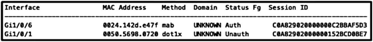

show authentication sessions
Refer to the exhibit. An engineer is configuring a client but cannot authenticate to Cisco ISE. During troubleshooting, the command was issued to display the authentication status of each port. Which command gives additional information to help identify the problem with the authentication?
The command 'show authentication sessions interface Gi1/0/1 details' provides additional information for a specific interface, including detailed debugging information about the authentication process. This detailed view helps to identify the problem with the authentication by providing an in-depth look into the status and configuration of the interface.

MORTNDOption: D
Jul 25, 2023
the question is: Which command gives additional information not Which command is shown here - because that is already in the question
NikoTomas
Mar 4, 2024
this is funny :) nice reminder!
collaOption: D
Jun 14, 2023
D is correct. The "details" keyword is the giveaway.
faridhOption: D
Aug 19, 2023
it looks for "ADDITIONAL" information
TiberiuszSunOption: D
Oct 6, 2024
Used on daily basis.
theorginOption: A
May 27, 2023
A is correct, its not showing detailed view
ZLHive
Jun 15, 2023
shutup
Ancash08
Jun 25, 2023
as shown port g1/0/1 cannot be authenticated. option D provides additional information to identify the problem
zoro3309Option: A
Jul 6, 2023
The output displays two different interfaces, so i will go with A
TiberiuszSun
Oct 6, 2024
but only the gi1/0/1 has unauth state. ;)
7614739Option: D
Jan 24, 2025
D is correct, A will only display to you what is already shown in the question. D will show you details into a specific interface.
