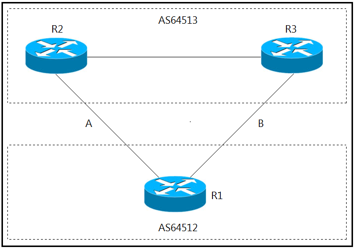

Refer to the exhibit. A network engineer for AS64512 must remove the inbound and outbound traffic from link A during maintenance without closing the BGP session so that there is still a backup link over link A toward the ASN.
Which BGP configuration on R1 accomplishes this goal?

Can someone kindly explain what this is doing? Is this making the traffic start to take Link B while traffic A undergoes maintenance? Also, what is the purpose of "set as-path prepend 64512" for link A? Isn't local preference enough? Please more input is appreciated.
JOKERR
Dec 15, 2021
That is correct. Config makes Traffic take link B while A is under maintenance. route-map link-a-in permit 10 --> Allow incoming routes from A route-map link-a-out permit 10 --> Prepend own AS-PATH so that AS-PATH becomes longer (for R2) to influence inbound traffic. route-map link-b-in permit 10 set local-preference 200 --> Set local pref for routes coming in from B. Default local pref is 100 so R1 will choose B over A. route-map link-b-out permit 10 --> permit all routes advertised to B. Hope this clears. Please comment any mistakes/corrections.
_Stupid_
Jan 25, 2022
It´s making R1 think that incoming and outcoming traffic from link A is taking an extra hop, therefor making the as-path longer for R2, reference to this links "We will now use a technique called AS path prepending, which consists of adding extra “fake” hops to a path using our ASN multiple times." https://nsrc.org/workshops/2018/ubuntunet-nren-bgp/networking/nren/en/labs/bgp-policy-as-prepend.html#:~:text=We%20will%20now%20use%20a%20technique%20called%20AS%20path%20prepending%2C%20which%20consists%20of%20adding%20extra%20%E2%80%9Cfake%E2%80%9D%20hops%20to%20a%20path%20using%20our%20ASN%20multiple%20times. and https://www.ccexpert.us/routing-switching/step-4-shortest-aspath.html#:~:text=The%20concept%20and,not%20be%20intended. You can check a configuration example here https://community.cisco.com/t5/networking-blogs/bgp-as-path-prepending-configuration/ba-p/3819334
