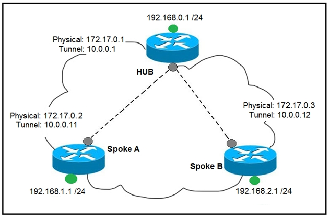

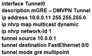

Refer to the exhibit. Which interface configuration must be configured on the spoke A router to enable a dynamic DMVPN tunnel with the spoke B router?

The correct answer is B. The configuration in option B correctly sets up a DMVPN (Dynamic Multipoint Virtual Private Network) tunnel with the proper NHRP (Next Hop Resolution Protocol) configurations needed for dynamic NBMA (Non-Broadcast Multi-Access) mapping. The physical source interfaces are correctly referenced, the NHRP network ID is specified, and the tunnel mode is set to GRE multipoint, all of which are required settings for a DMVPN setup. This ensures spoke-to-spoke connectivity via the hub.

B - only possible answer, all other sources are incorrect and B has correct NHRP map for the hub and NHS.

The given answer is correct Look at the tunnel source and destination

B will not allow spoke to spoke tunnel. ip nhrp map multicast dynamic and tunnel mode gre multipoint are required. I think the question would assume phase 1 already configured and working. Then would go with A to change it to phase 2

It is hard to choose from these answers. Phase 2 would really need this on the spokes: #ip nhrp map multicast x.x.x.x (#ip nhrp map multicast dynamic -> it is configured on the HUB, so obviously incorrect) https://www.cisco.com/c/en/us/td/docs/ios-xml/ios/sec_conn_dmvpn/configuration/xe-16-7/sec-conn-dmvpn-xe-16-7-book/sec-conn-dmvpn-dmvpn.html

Choosing "B" after all. - As any other answers are completely wrong. #ip nhrp map multicast x.x.x.x (NBMA of HUB) is still missing from "B".

A is not correct, tunnel source can't be 10.0.0.1 B seems to be ok C is not correct, missing multipoint on tunnel mode gre. D is not correct, ip nhrp map multicast static is not a valid command. The correct answer is B
