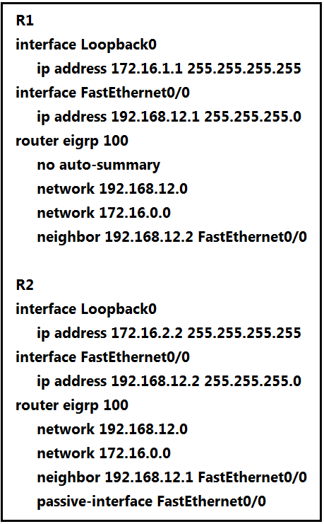

Refer to the exhibit. R1 and R2 cannot establish an EIGRP adjacency.
Which action establishes EIGRP adjacency?
The passive-interface command in the R2 configuration prevents EIGRP packets from being sent out through the specified interface (FastEthernet0/0), which in turn stops EIGRP from establishing a neighbor relationship with R1. To enable an EIGRP adjacency between R1 and R2, the passive-interface command should be removed from the R2 configuration. This will allow EIGRP packets to be exchanged through the FastEthernet0/0 interface, thereby enabling the establishment of the EIGRP adjacency.

Given answer is correct, labbed and as soon as you configure passive-interface it tears down the neighbor as below. EIGRP-IPv4 100: Neighbor 192.168.12.1 (Ethernet0/0) is down: interface passive

C is correct. The passive-interface command stops EIGRP packets from going out through a specified interface. You'd use it on interfaces where you don't want EIGRP to make connections, like on LAN interfaces with no EIGRP neighbors around.
