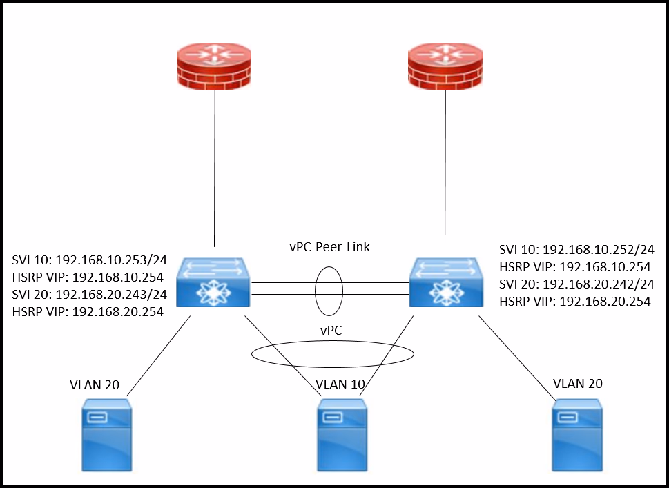

Refer to the exhibit. An engineer discovers that if the vPC peer link goes down, half of the devices in VLAN 20 experience connectivity issues with the external networks Which action resolves the issue?
In a vPC setup, if the vPC peer link fails, traffic for VLANs that are part of the vPC peer link might face issues if not properly managed. By excluding the non-vPC VLANs from the vPC peer link, you can ensure that these VLANs do not rely on the vPC peer link for their communication. This helps provide better isolation and ensures connectivity even if the peer link fails, resolving the connectivity issues observed with VLAN 20 in this scenario.

Here Should be A
Winnah
Oct 13, 2024
Based on what?
scorpfeOption: C
Apr 8, 2025
Should be C
