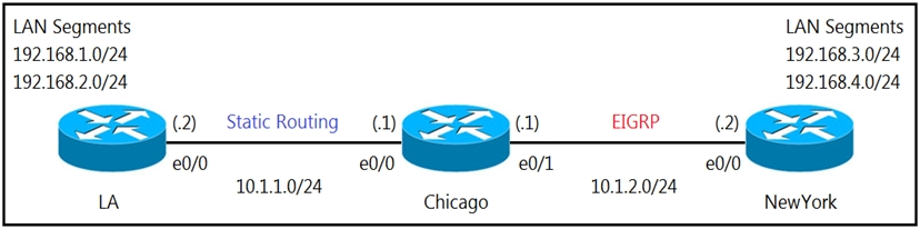

Refer to the exhibits. A user on the 192.168.1.0/24 network can successfully ping 192.168.3.1, but the administrator cannot ping 192.168.3.1 from the LA router.
Which set of configurations fixes the issue?

The problem is that the administrator on the LA router cannot ping the 192.168.3.1 address, even though a user on the 192.168.1.0/24 network can. This indicates an issue with routing information propagation between the routers. In the given scenario, the Chicago router uses EIGRP and redistributes static routes to the NewYork router. However, the routes for the connected network 10.1.1.0/24 (on the LA side) are not known to the NewYork router. To fix this, the Chicago router needs to redistribute its connected routes so that NewYork will know how to reach the LA's 10.1.1.0/24 network. Therefore, the correct answer is to configure the Chicago router to redistribute connected routes into EIGRP, providing NewYork with the necessary routing information to respond to pings originating from the LA router. The correct configuration is option D, which ensures that the Chicago router includes its directly connected networks in EIGRP advertisements, thus solving the connectivity issue.
