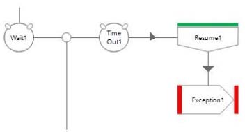

Which of the following flows can you not create in Blue Prism? (select 2 responses)
A.
B.
C.
D.
In Blue Prism, you cannot create flows that violate the rule of connecting stages that are inherently not supposed to be connected. Specifically: 1. The 'Recover' stage cannot be connected directly from any other stage, and it should not have incoming links as it is designed to be the entry point for recovering from exceptions that are thrown in the process. 2. The 'Exception' stage is designed to throw an exception and cannot have outgoing connections to other stages, as it represents the point where an error is raised to be handled by the 'Recover' stage. Based on these rules, the flows you cannot create in Blue Prism are the ones in options A and B. Therefore, the correct answer is 'A and B'.

Should be A & B
770_is_everywhere
May 12, 2022
its insane!!! everything is wrong.... first of all 'wait' stage can only used in 'Business Object' take also the fact that you can't use 'Resume' stage and 'Recover' stage in business objects... - but 'Exception' stage can be used. wich means... you right - A,B&C is impossible even to create!! B it's also wrong because we can't take next step after 'Exception' stage Btw you also cant link to recover stage (another reason that A is wrong) i fill that those questions try to make you fail in the exam... why not just to ask a clearly question ??...

These four diagrams are not complete diagrams that we are not sure if there are Recover stage outside what is being shown to us, such that C and D are possible. However, A and B are definitely impossible. The Blue Prism syntax doesn't allow the Recover stage to be connected from anything; nor does it allow the Exception stage to connect to anything at all.

Yes, A and B is the correct answers.

But I the Resume stage must be in the Recover stage. So A, B, C&D cannot create on blue prism.

It's only good practice, when it comes to C and D, but from technical perspective, you can create paths C and D.

From what I learned and understood, a Resume stage can not be used without Recover. Its a couple right? or am I mistaken here?

The Recover stage could be outside what we can see. However A & B can never happen

yes try it, it will not work without recover stage

I've tried them all, All are wrong and all will pop up an error or not able to be done

A & B BECAUSE C&D ARE ALSO WRONG BUT POSSIBLE TO MAKE IN BP you cant conect something to a recover and you cant conect something from a exeption

A & B You cannot create links to resume stages or links from exception stages.

A and B Recover is a hanging stage, no arrow TO it allowed exception has no right to have arrow FROM
