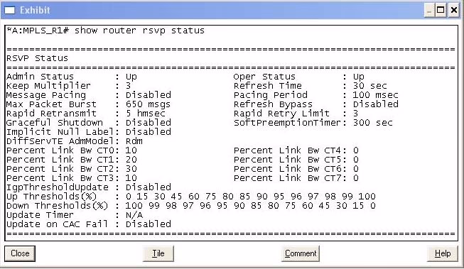

Click on the exhibit button below.
Given the configuration shown, how much of a link's 100Mbps reservable bandwidth can an LSP access when configured for class-type 0 and priority 1?
Based on the exhibit, the Percent Link Bw CT0 (which corresponds to class-type 0) is 30. This means that 30% of the link's reservable bandwidth, which is 100Mbps, can be accessed by an LSP configured for class-type 0 and priority 1. Therefore, an LSP can access 30Mbps of the link's bandwidth.

can anyone explain, how it is calculated
