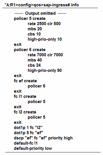

According to the SAP-ingress QoS policy shown, which of the following statements about packets processed by policer 6 is TRUE?
Exam 4A0-107 Question 43
Since the CIR (Committed Information Rate) is equal to the PIR (Peak Information Rate) for policer 6, there is no excess bandwidth consumption possible because the rates are the same. Therefore, all forwarded packets will be considered in-profile.

I believe A is correct, CIR = PIR, so all packets will be set in profile

Yes, A must be the correct answer.
